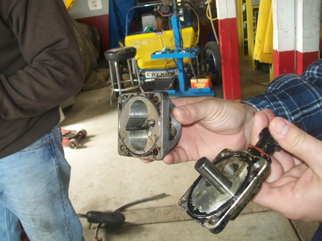

« Reply #11 on: March 07, 2010, 07:33:07 AM »
Interesting oil pump. None of us have ever seen one in this configuration. Can anyone shed a little light on this design? Manufacturer?
Seems to me to be a decent design. The shaft that the gear rotates on is part of the pump cover and is supported at both ends unlike the designs I'm used to seeing with the gear floating on the shaft that is cast into the pump body.

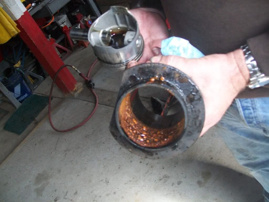

« Reply #12 on: March 07, 2010, 07:39:05 AM »
Tom knew there was a possibility that water may have gotten into the engine during the several years the motor sat idle. as I pulled the drain plug I guessed a 5 second count of water draining out before we actually saw oil. Well the caount actually went to 13 before we saw what oil was in the motor. Once we loosened up the heads an ugly rust colored water started leaking out between the head and cylinder at number 3.

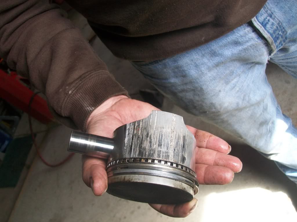

« Reply #13 on: March 07, 2010, 07:44:10 AM »
Now that we got the heads and cylinders off, we can identify the displacement....90.5
Number one piston is a bit scuffed.

« Reply #14 on: March 07, 2010, 07:46:02 AM »
After we found water in the engine, Rich took a closer look at the carbs....how else is the water going to get in?
