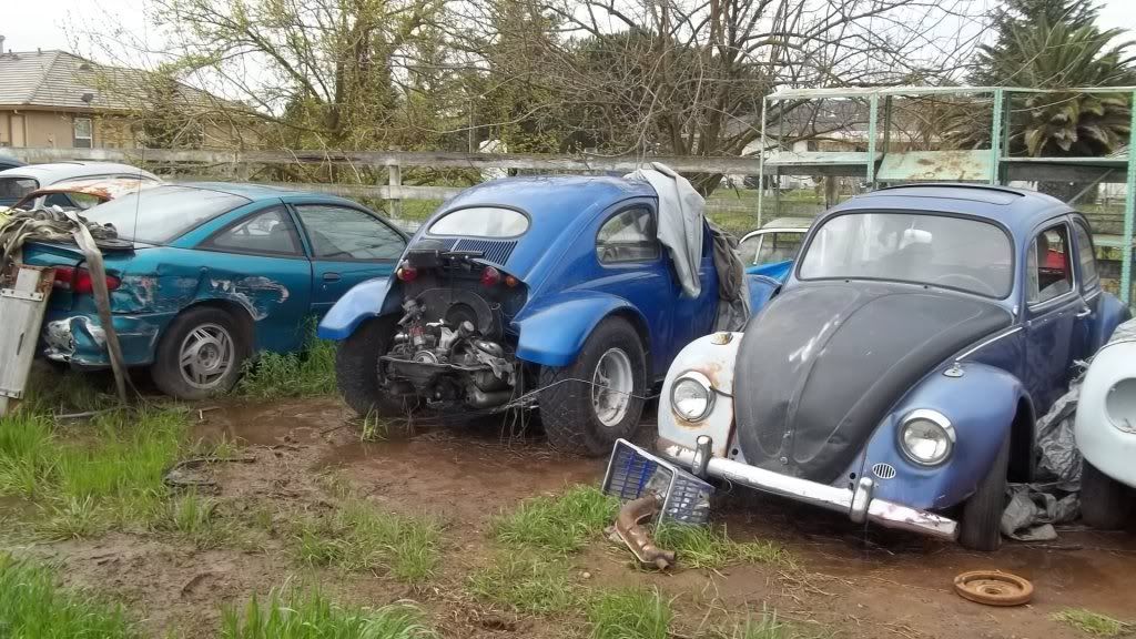

It has been sitting in this outdoor spot for about 2 years. It has been kept covered for the most part but some of the stronger wind driven storms has had me struggling to keep it under wraps. Now that the Baja is on deck, it will get the TLC it deserves.
Here is how it looks today before we pulled it from the long term parking area:

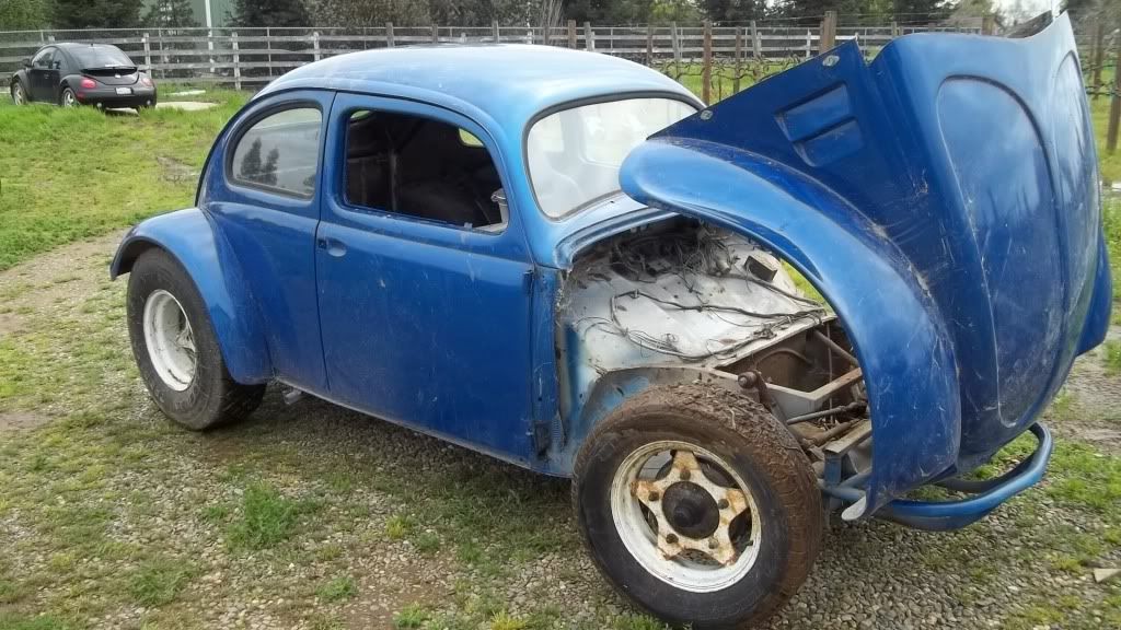

We celebrated getting the Oval out by Moto X-ing the Golf Cart around the Vineyard a couple times until we got stuck. Gotta love playing in the mud!
Here's some initial shots of the Baja before I get into it:

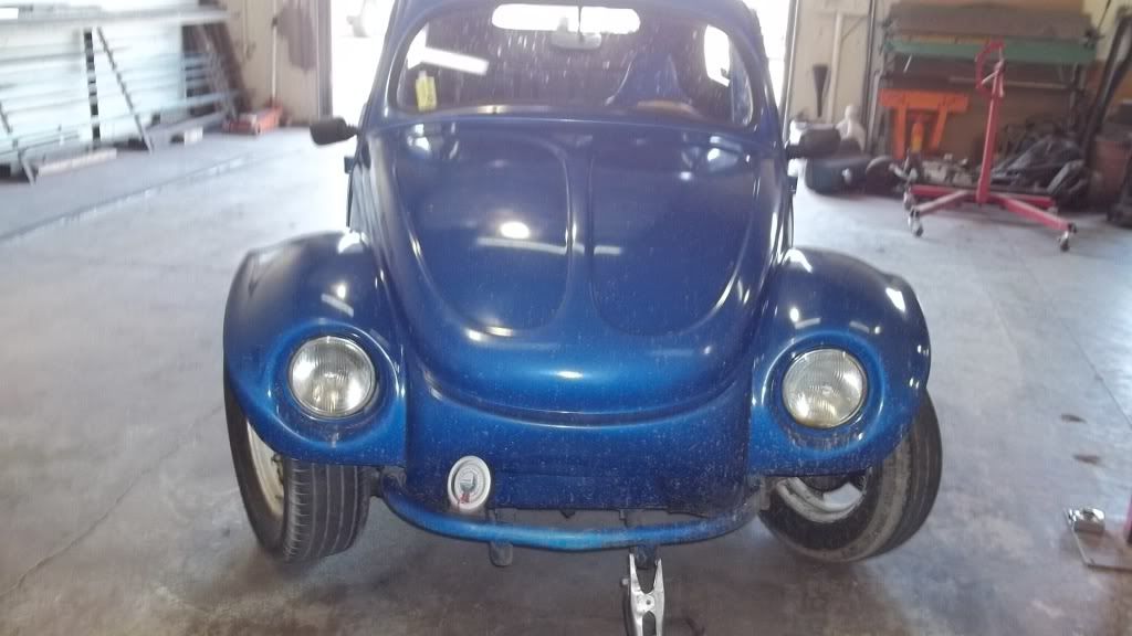

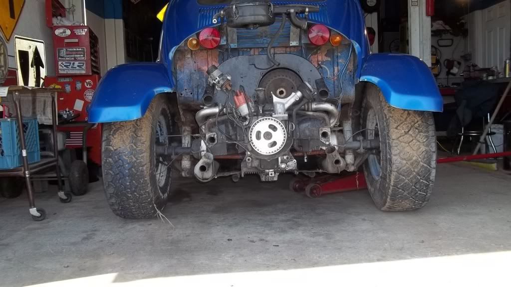

Well now that I got the Baja out and on-deck, things started to happen. First of all I took the power washer to it. In addition to cleaning it, I tried to knock down all the spiders. Also found some abandoned Wasp nests. That could have been ugly if those little bastards were active.
I let it dry over night and them I moved the Baja into the batters box....errrr workstation.
Here's how it looked before I got to wrenchin on it. I did notice some camber in the rear wheels so I may end up bringing it up a notch at the spring plates.

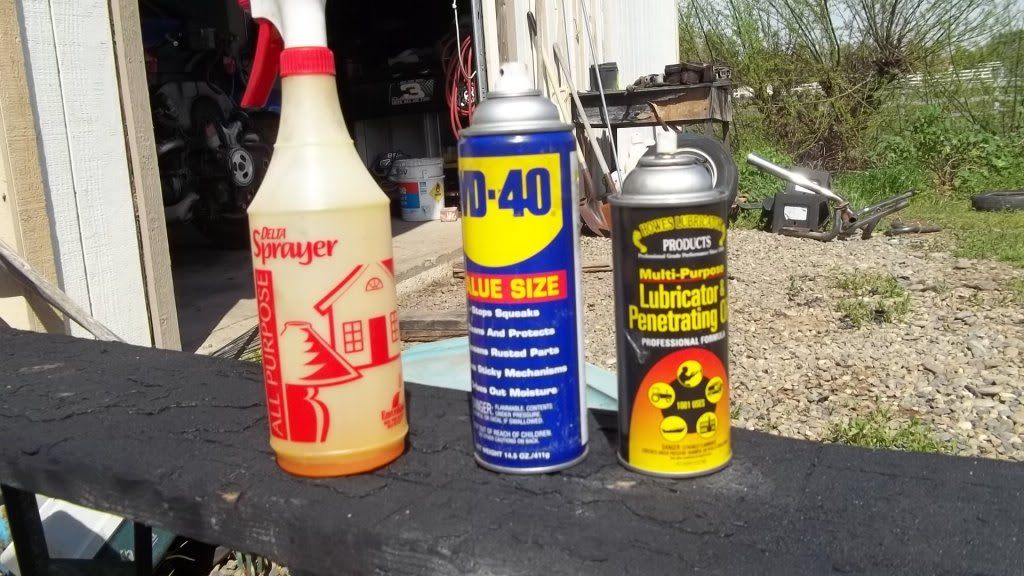

First things first! I got out my penetrating oils and started to hose down all the buts, bolts, hinges, etc.
First bottle has PB Blaster. I buy it in gallons, one of my favorites. Go ole' WD40 which I use when lingering fumes can be a problem.
The last can is Howe's penetrating oil. This can only be found at Truck Stops and from what I understand, they swear by it. A good friend of mine turned me on to this stuff and I value his opinion. I bought 2 cans at the Truck stop at HWY 12 and Interstate 5 in Lodi (Kettleman exit?). It was a bit on the pricey side. I'm almost done with the first can. The jury it still out on the Howe's. I'm not sure if it is any better than PB Blaster.

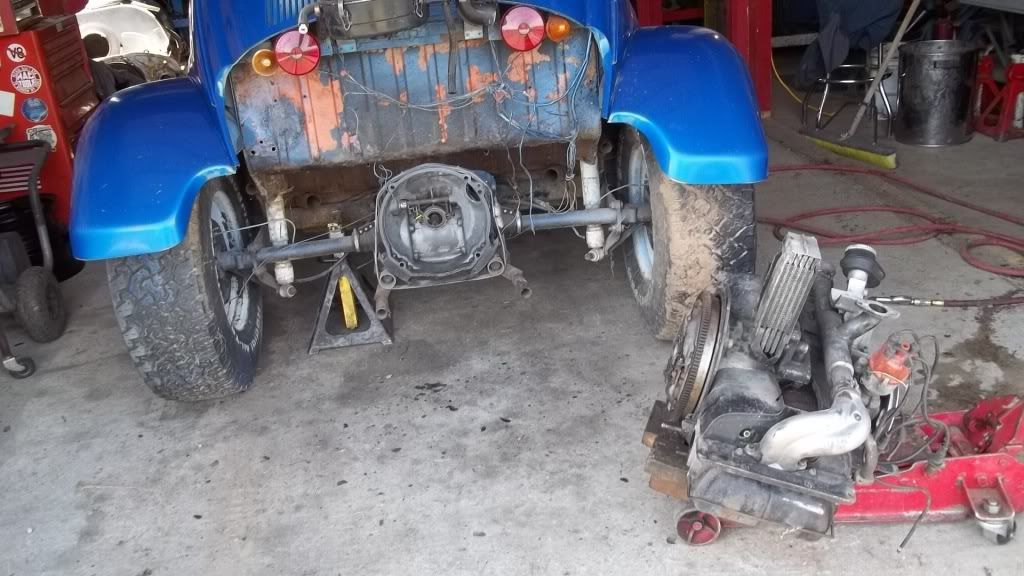

Out comes the motor.
I will pull the heater boxes and install a Bobcat style exhaust. The Doghouse fan housing is cherry. So cherry in fact that I decided to pull it to use on another application. I dug through my fan housings hoping to find a 36Horse/Dog House fan housing without the heater hose outlets.
No luck so I decided to use a beat up original one that I found. I mean it is a Baja after all right?
I checked the clutch since I had the motor out and found out that it was literally brand new. While I was there I went ahead and installed a new flywheel seal and O-ring.
I blew off the rest of the engine when the fan housing was off. Spider nests everywhere.

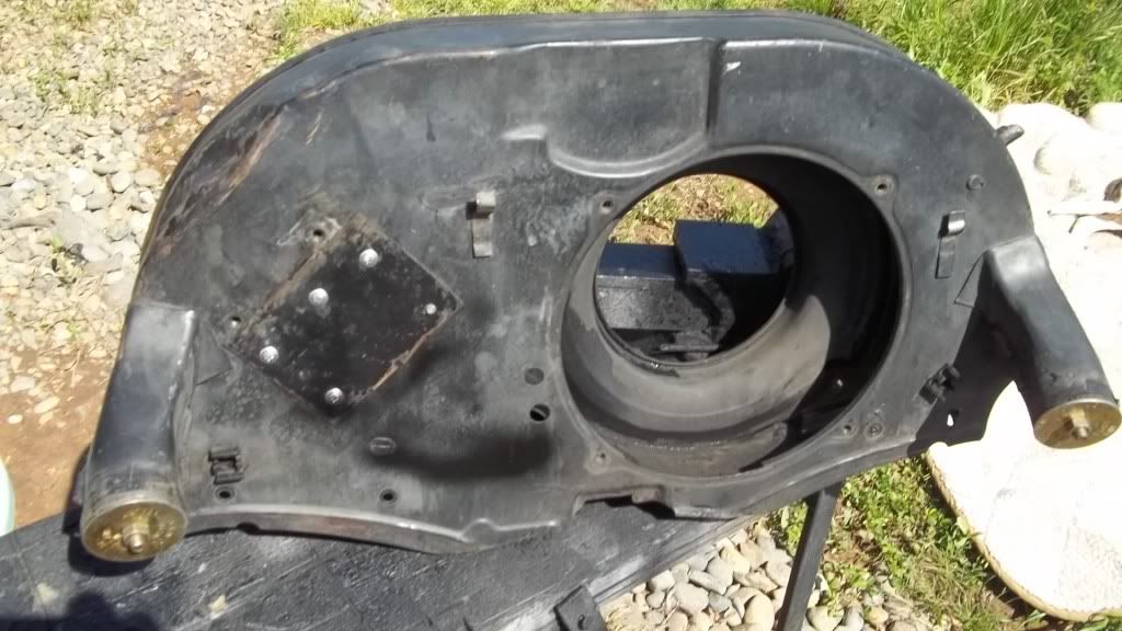

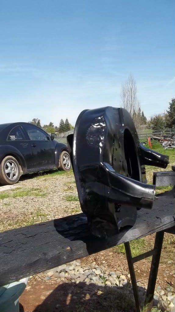

Here's that beat up fan housing that I found. It looked like someone shot a hole through it. You can see the patch made out of a bottom cylinder tin on the front side. The exit hole on the back was welded up.
I added a few more screws to the patch, installed expandable freeze plugs into the outlets, rattle canned-it and called it good.
It doesn't look too bad but the left side is bashed up pretty good. I'll continue to look far a 36Horse style, but for now this one will work. Heck it's an original German.

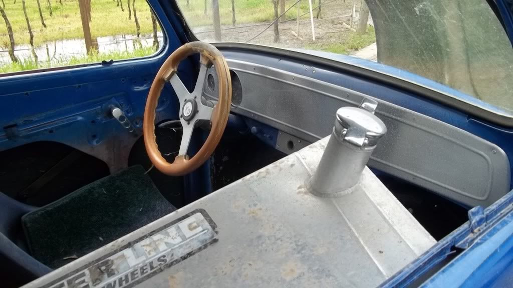

There is still a ton of things to do. I had put aside a couple of gas tanks to look at for the Baja. One was a poly fuel cell the other was the Aluminum Twin Filler tank you see in this picture.\. To use either one I would have to do some fabrication to make them properly fit.
I looked at the opening where the original tank went. It had been modified in that area for the flip front end mount to fit. I found a tank that fits 58-67 and gave it a trial fit. No way, too big.
I thought to myself, "Wouldn't it be funny if an original Oval tank fit in there?".
I was pretty sure I didn't have an original tank, but something prompted me to go check anyway.
My lucky day. I found a tank and it dropped right in to the opening.

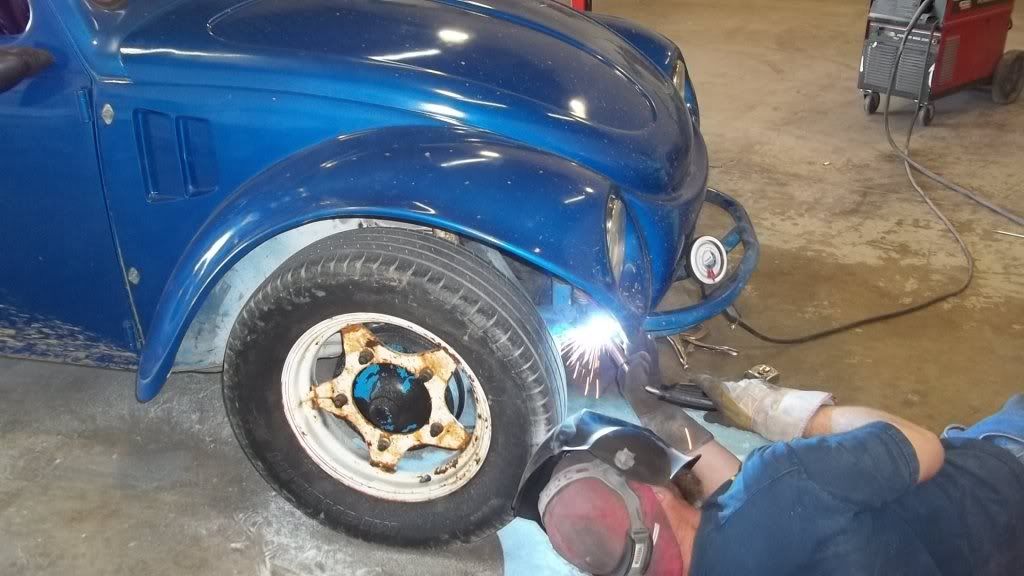

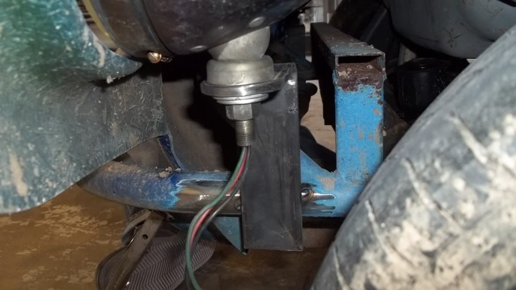

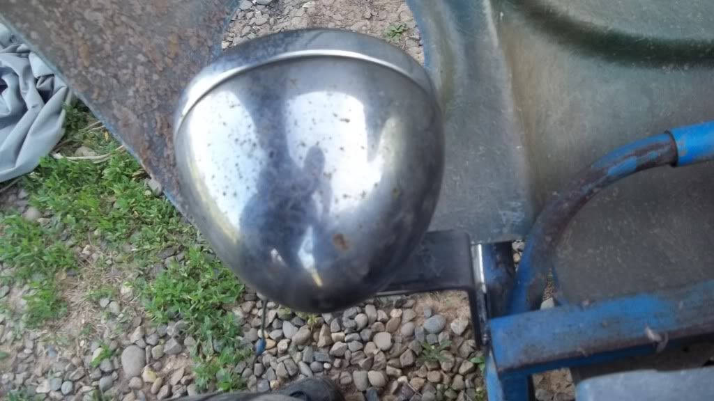

I had to had to get headlights miunted to the Oval Baja.
Since the front end is one piece tilt, best bet was to solid mount the headlight bucket assemblies behind the opening. Since I wanted it done right, I made a visit to Deluxe Iron and to consult with Doug Colley. He was kind enough to break away from his endless tasks of building racecars and squeezeed me in to his tight schedule
First thing he had to do was cut and bend some flat steel then grind down the mounting area for a good weld and penetration.
Doug tacked the mount into place and checked alignment.
Once everything lined up, the mount was welded it into place.
When I got home I pulled the buckets back off to add a little paint. Looks pretty good. Now I'm legal.....sort of.

Took the Baja out to Prairie City SVRA for a shakedown and it worked pretty well. I rook it pretty easy and noted a couple of weak points.
